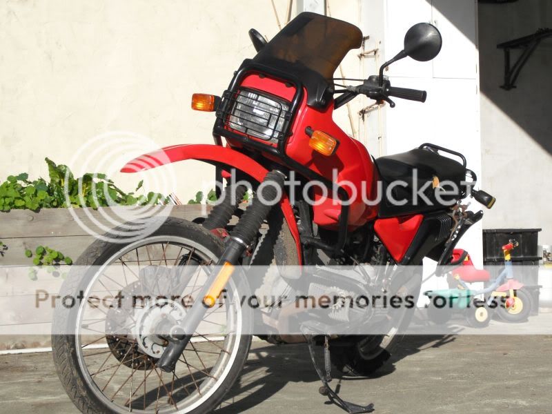

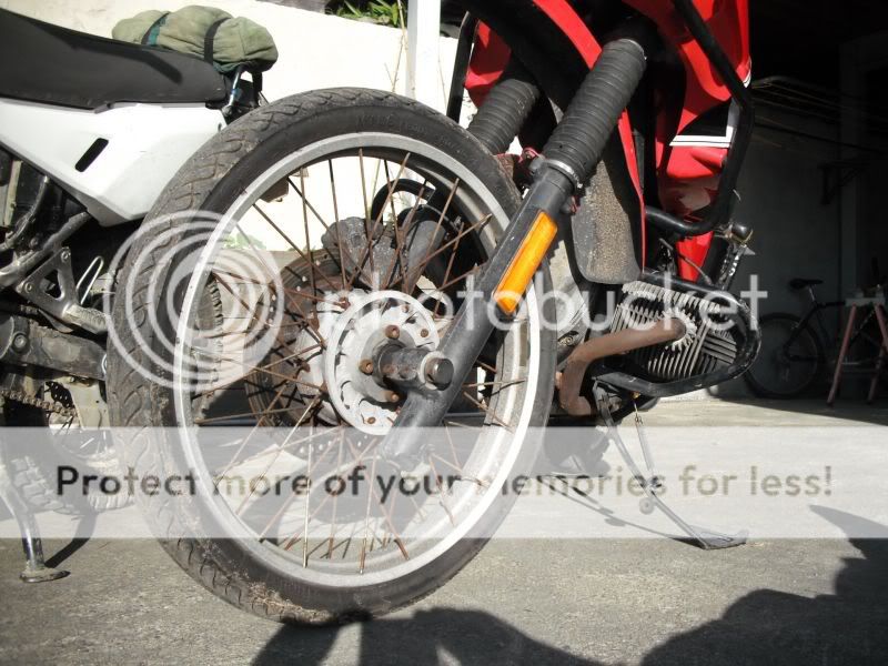

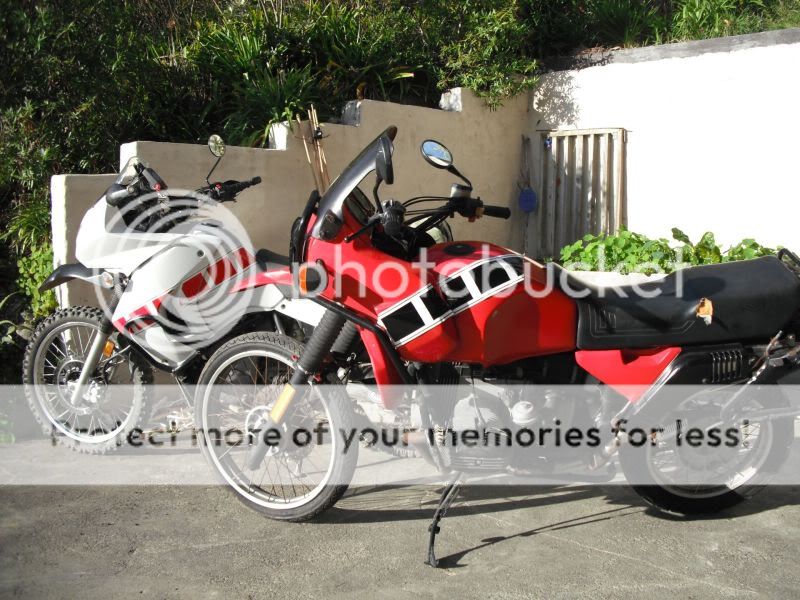

    I arrived home from Hamner on Sunday night to find a new-to-me airhead parked under our house.
    I managed to find some time to have a look at it yesterday & it is certainly a lot better than I thought it would be.
    It has an oily butt & the anodising & rust needs attention but looks not too bad.
    Of course it didn't take long for me to get into customising mode.
    Here's my boys

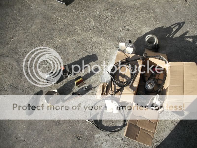

    As well as coming with the most goddamn awful panniers ever seen it had a nearly complete workshop ful of tools under the seat as well as some suspect looking spare parts.
    i will email the PO & ask him what has been replaced & what may need doing. i had it running off a battery boost but wouldn't run if disconnected so am getting a new battery tomm as well as oil, filter & after that take it for a spin before I clean carbs & start the laborius task of removing the rust.
    Once again many thanks to Anthrax for shipping it from Auckland to maramaura & javahead for storing it & dropping it off to my front door. Also thanks to Top & Warewolf & Eddie b fopr their input.

    FFS Paders, how about I just sell you a proper Tenere. in need of a bit of t.l.c. but I'm sure you can take care of that.
    Beemer looks o.k. though, I might have to swing by and give it the once over m'self
  14. #704
    5th September 2008 - 19:38
    Wairarapa
    4,375
    still think you should paint that front guard white....
    JMJ
  15. #705
    9th May 2007 - 16:10
    Here
    4,513
    It's still got a Harley front tyre Remove that and the thing will run sweet.
