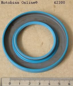

    Hi guys. i've just posted this on olds cool in case anyone can help.
    cheers
    http://www.advrider.com/forums/showthread.php?t=621563
  8. #968
    7th August 2003 - 21:02
    R1150GS & R80GS Basic
    Waimauku
    304
    cheers
    This is the one that I have in my gearbox
    There is also a black one. I didn't do the job myself, because getting to the seal involves a long lever and a lot of torque. I was told that either seal will work. There is also a small v-slot that needs to be sealed. Hope this is not too abstruse.
    From Joerg's website:
    http://jhau.maliwi.de/mot/gearbox.html
    R1150GS
    R80GS Basic

    Padmei, how much oil did you put in your gearbox at last change? Did you fill to quantity, or until it just started to dribble out of the fill hole when on the centrestand? Take the gearbox fill plug out while its on the stand & see if any comes out (an indication of an overfill). A little leak can go a long way. Unusual for it to come out the left side - you obviously use your side stand a lot. Is your breather clear (the bolt holding the earthstrap on & the speedo cable in the gearbox). Take it out & inspect it. If its blocked, then when the oil expands as the gearbox gets hot, it blows out the output shaft seals.
    My last gearbox leak was an overfill. It didn't continue once I remedied that issue. If you attend to this & the breather, it may be fine.
