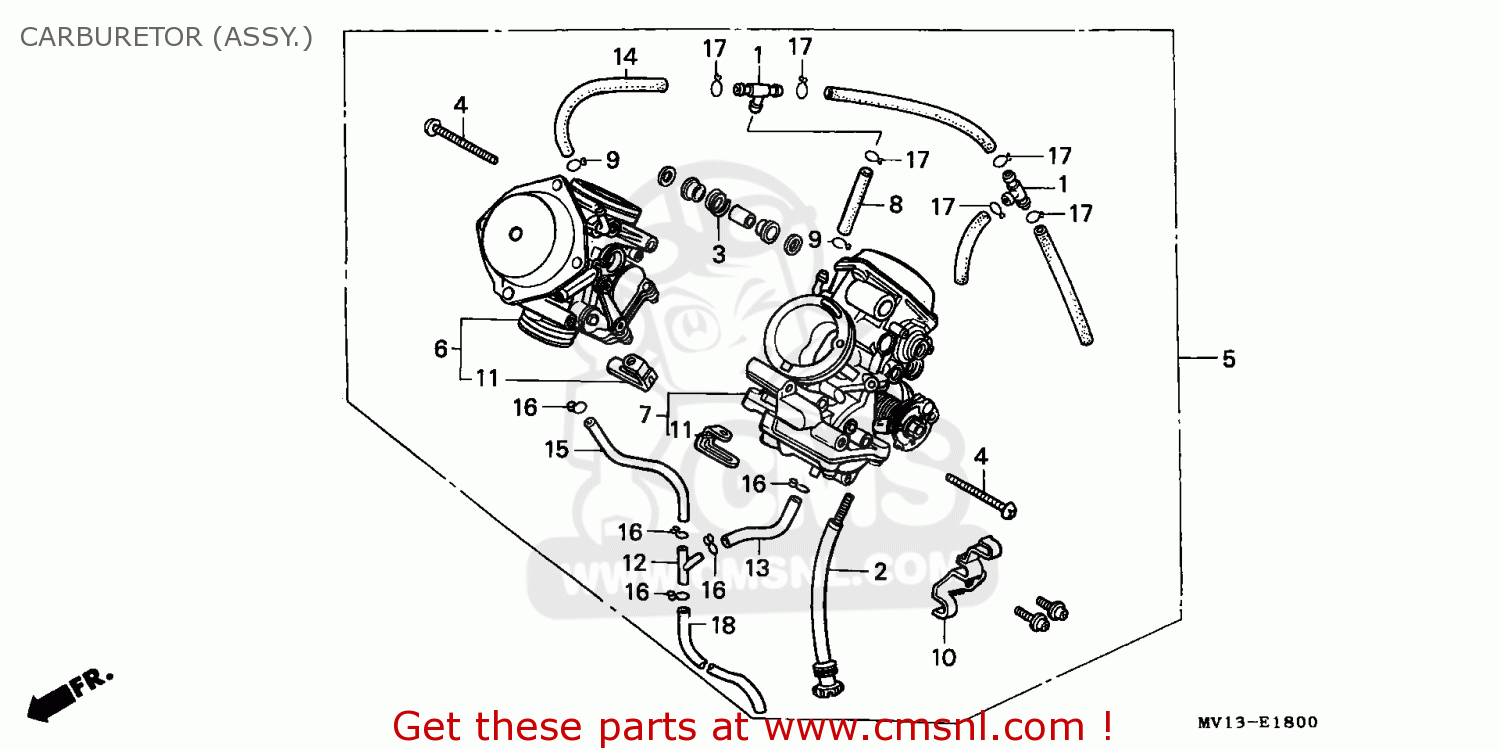

    Carbs need a strip and rebuild too as she runs pretty rich down low below about 2800.
    CV carbs?

    Quote Originally Posted by buggsubique View Post
    Buggered if I know actually - certainly not the FCR pumper the DR-Z used to have! What should I be looking for?
    Those caps say CV carb to me. There's a diaphram under each that's connected to the slide. The butterfly opens and vacuum lifts the slide. At low revs the needle can be moving up and down a bit with each engine pulse.
    If the idle is erratic and it's boggy off the bottom, it could be the needle jets.
    They can get worn ovalish by the sides of the needle.

    P.S. XTZ750 Super Tenere's were famous for wearing the needle jets oval in very short time frame. Nickel coated jets are available from Factory Pro for the XTZ750 so I'm guessing you should be able to get some as well. About $100 when Bro did it.
