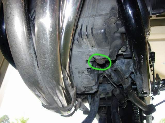

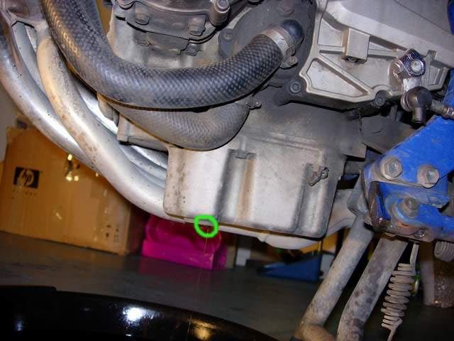

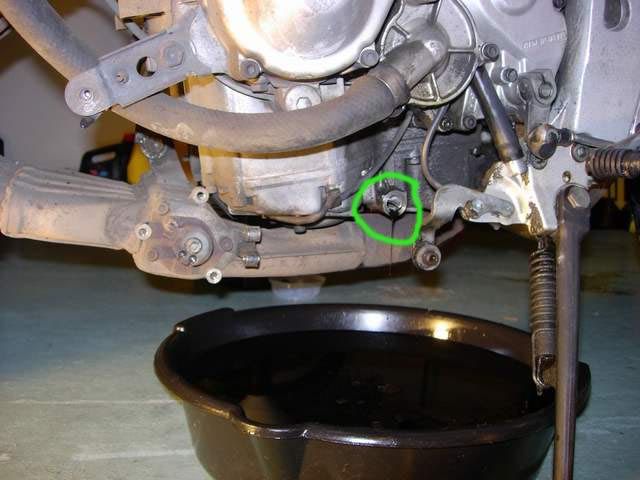

    Find the sump on the bike, usually at the bottom of the engine. Looks like a box. There will be a bolt in it. That is usually your sump plug.
    some of them are on the side of the sump.

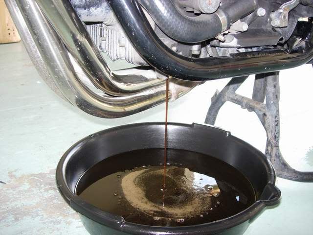

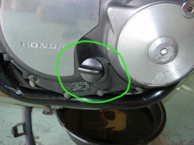

    Place your oil pan below the sump plug. (Oil will come out of this plug, so be careful. OPEN your oil refill cap.
    Remove it with your rachet and socket set.
    Just before you completely remove the bolt, get ready for the oil to pour out, so you might want to bring the oil pan up near the sump. Once the bolt is removed, oil should pour out from the sump and in to the pan. Wait until nothing more drips out.

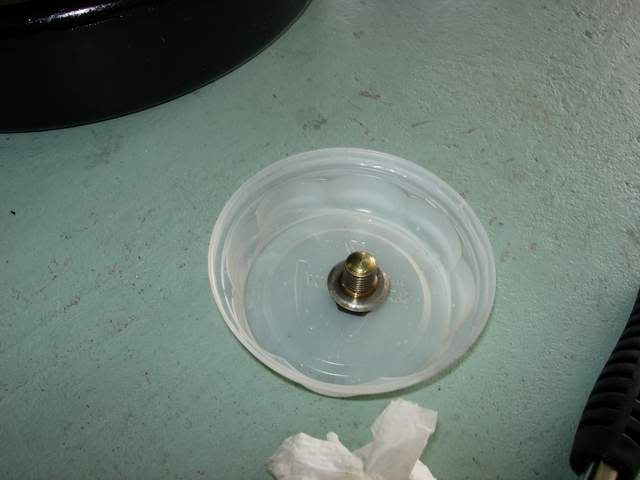

    Sump bolt

    Put the sump bolt back in to the sump and tighten. Do not over tighten. It doesn't need to be SEALED on there, it only needs to be tight enough so oil doesn't leak.
    Fill with oil.

    3. It pays to replace the crush washer on the sump plug every so often. This is usually aluminium, and is designed to help seal the sump plug without it having to be ridiculously tight. After a few oil changes, they can get , well, crushed (as intended), so they lose their effectiveness.
