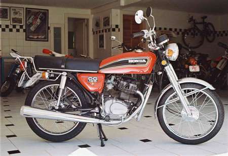

    Quote Originally Posted by Sully60 View Post
    My first race bike...
    CG125? 5"sls front?
    Extravagantly opulent. The pinnacle of all things deceleration, naught wrong wiv it.
    My first bike's brakes consisted of a pair of pliers with a cable through the handles, around the back sprocket, with mebe a square inch of pad riveted to the jaws. Seriously.
