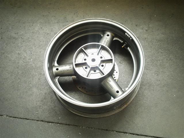

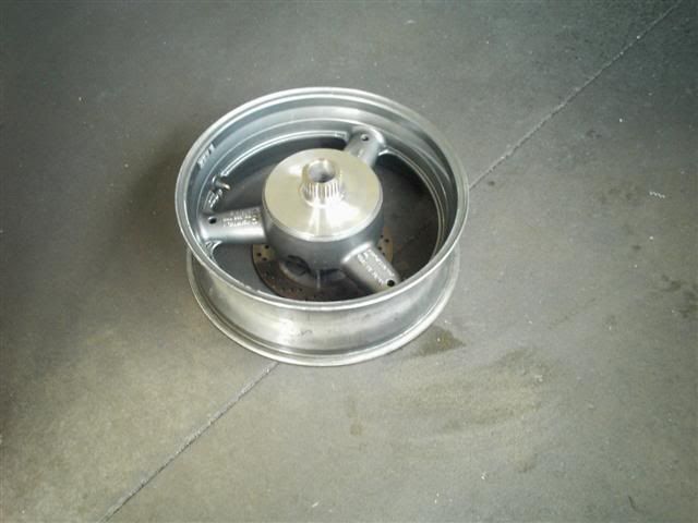

    I'm not sure if you guys are really into this sort of stuff or not , but I'll post it anyway.. I'm chopping my next project and converting the rear wheel to a wider Suzuki 200 so I made an adaptor for it...

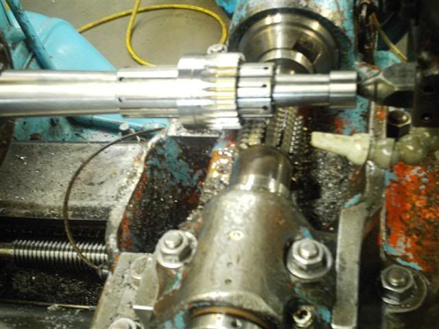

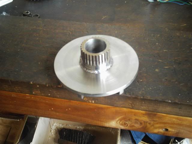

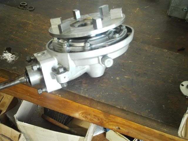

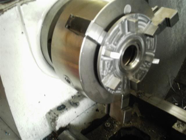

    To make the drive flange fit the wheel I first had to machine down some of the bearing spigot face inside the wheel to allow the flange to fit down enough. Next op was to mill the drive tabs on the drive flange to mate with the cush drive and then bore out the flange to accept the drive spline that fits to the drive plate flange.

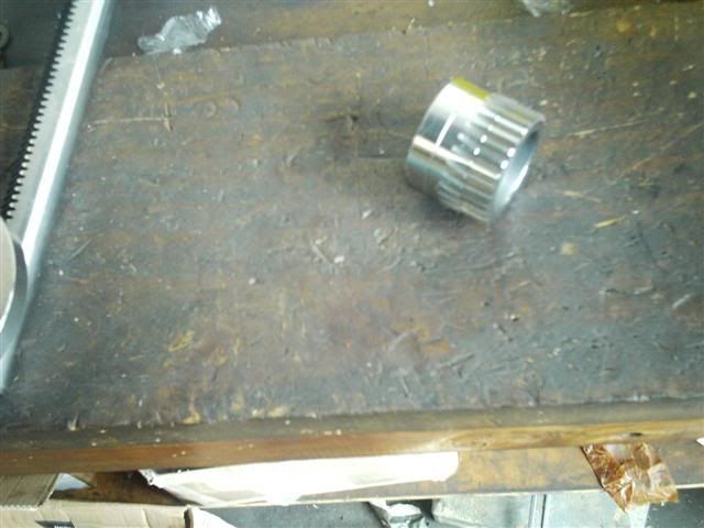

    The drive spline was bored hollow and gear cut on expanding mandrel as shown in one of the pictures. A picture also shows the drive spline after I cut it.
    I pressed the drive spline into a recess machined in the drive plate and tig welded on both sides of the plate. The drive plate fits into the cush drive and the spline mates to the shaft drive unit.
    The original drive shaft to motor gets pulled out and next task is to make the universal joint to drive unit spline adaptor so it fits it. The concept is to run unviversal joint to universal joint so that no offseting is required from the motor output, so in other words the drive shaft will be running at an angle. More pics will follow when I finish the universal joint splines and I'll also make a new shaft between the U/j's. I expect to run the rear end about 3-4" longer
    than stock.

    Next part of this was to make a universal joint to fit the drive unit. I got one from a bike wrecker down the road which was out of another shaft drive from something or other which I'm not sure, anyway I had to dismantle it to machine it. One pic shows the U/J that has been machined down to accept a splined sleeve made to suit it, also in the picture is a rear cap for the U/J which has a blind hole in it for a push spring that runs inside the drive unit. This is to allow the yoke spline to float slightly back and forth over its length to stop any binding thru the arc travel of the swing arm. That kind of setup is really just like a common tail shaft setup from a car where the tail shaft can slide up and down a little on the slip yoke to stop any binding from any short movements. One other pic shows the reassembled and mounted U/J inside the the drive unit and is ready to go apart from the axle, rear U/J to motor U/J and a shroud which I'll make to keep the crap away from the drive unit /wheel, plus a sleeve will need to be made to run between the drive unit and first wheel bearing so it doesn't crush the bearings when the axle is tightened.
