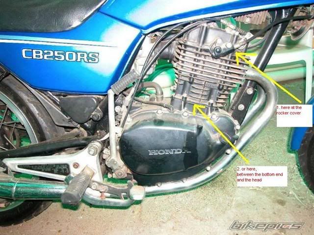

    where exactly is it leaking??
    between the top of the head and the rocker cover,
    or lower down, between the bottom end and the lower part of the head??
    if its there then you'll have to pull the head, if its just the rocker/valve cover (top cover) then just that,
    post a photo
    i am guessing its a dohc engine and not some old skool push rod engine,
    what bike

    Quote Originally Posted by hmmmnz View Post
    post a photo
    what bike
    Hehehe, no pushrods here. Yep, it's leaking in the top arrow you pointed out, between the head and the rocker cover (I called it a valve cover, that's just what the Haynes says). So I'll just pull the rocker cover, nae sweat. Want to see what that camchain tensioner is up to after a few kms anyway.
    That bottom arrow is actually between the barrel and the crankcase -- there was a tiny amount of leakage from there when I first got the bike. Found out why when I pulled the barrel when I did the rebuild, the base gasket was in about four pieces. Apparently a common problem with these engines -- perhaps why in the gasket set I ordered there were two base gaskets?
